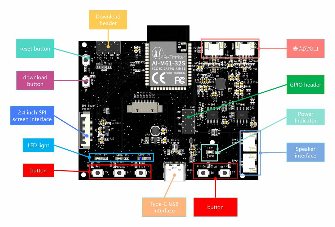

1. Overview
AiPi SCP-2.4 uses Ai-Thinker Ai-M61 module as the control core. The Type-C interface is used for power supply. The 2.4-inch RGB LCD screen is connected through the SPI interface, and the external audio circuit is used for voice broadcast and button group for physical control. The Ai-M61-32S module equipped has rich peripheral interfaces, including DVP, MJPEG, Dispaly, AudioCodec, USB2.0, SDU, Ethernet (EMAC), SD/MMC (SDH), SPI, UART, I2C, I2S, PWM, GPDAC, GPADC, ACOMP, GPIO, etc.
