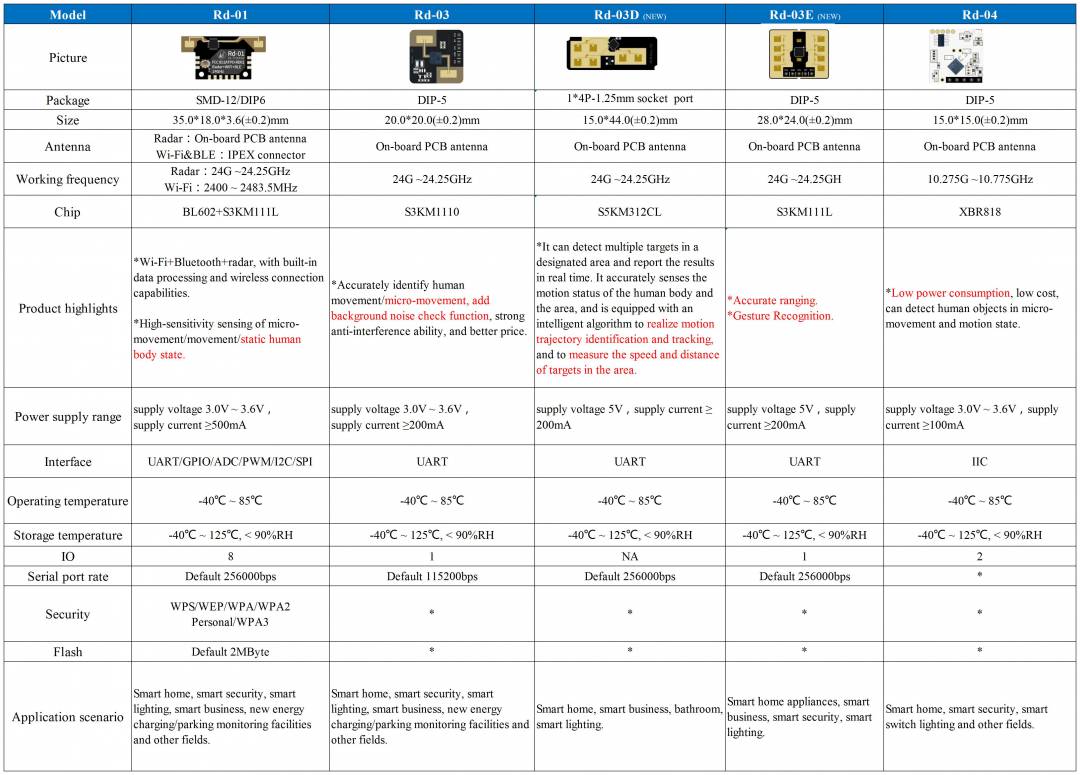

Select table: Radar series parameter comparison
