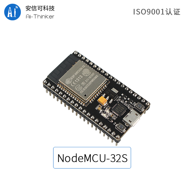

Overview
NodeMCU-32S is a core development board designed by Essence based on the ESP32-32S module. The development board continues the classic design of NodeMCU 1.0, leading most of the I/O to the headers on both sides, and developers can connect peripherals according to their needs. When using the breadboard for development and debugging, the standard headers on both sides can make the operation easier and more convenient.

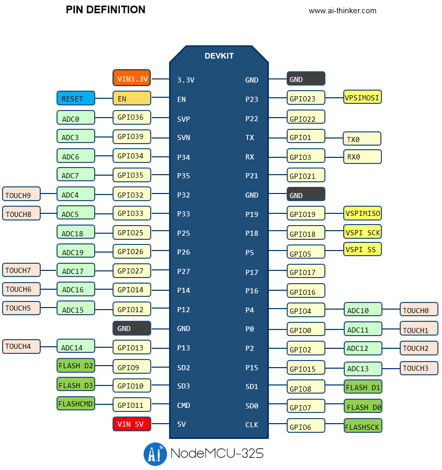

Pin Diagram

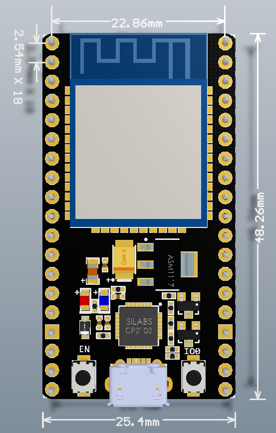

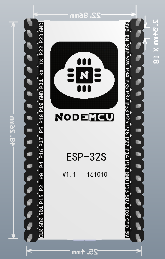

Dimension drawing

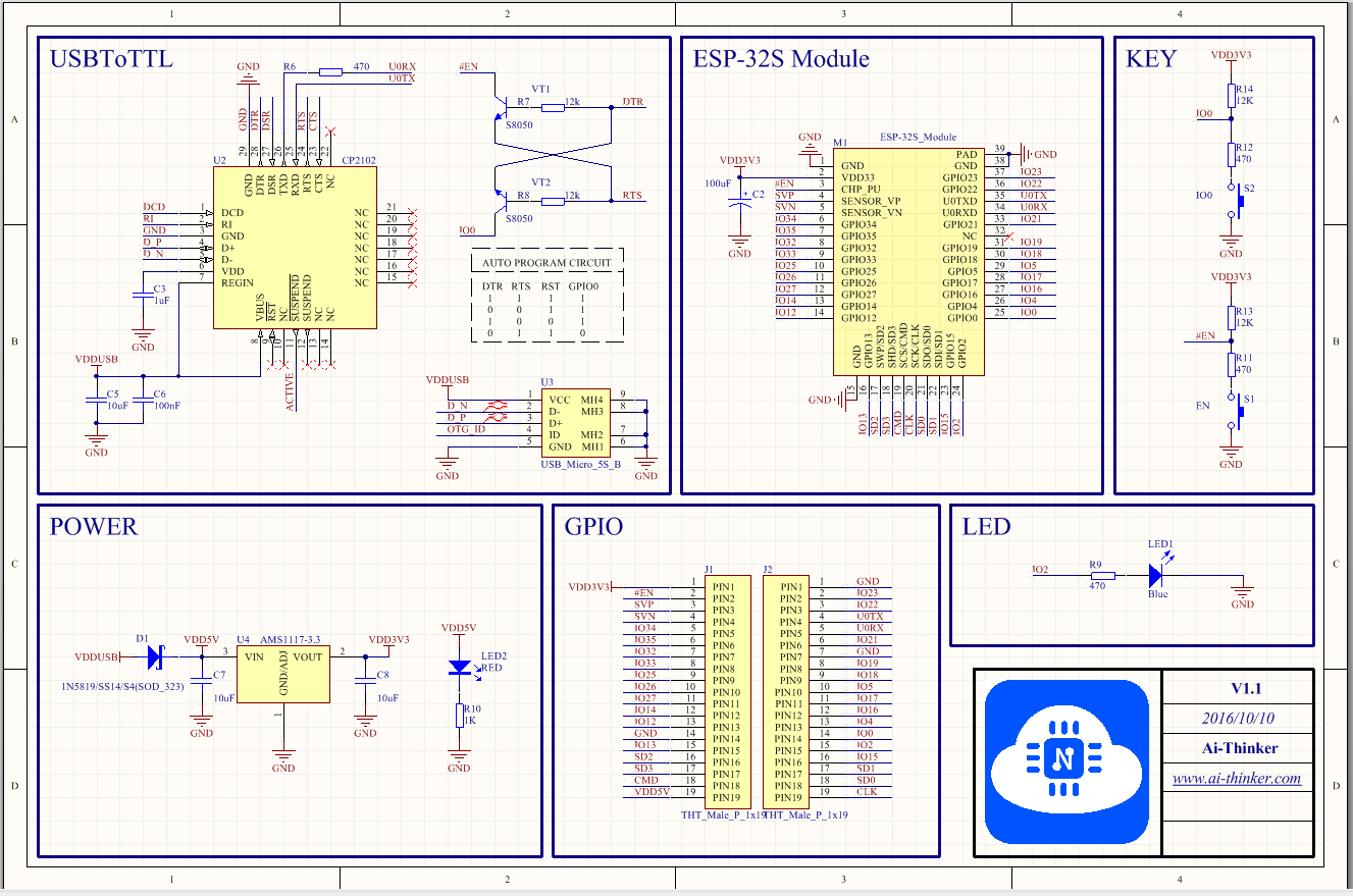

Schematic diagram

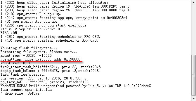

After the download is complete, use the serial port tool to open the port, view the data output, and print as follows:
When the program is executed for the first time, the file system will be formatted automatically, which will take a long time, please be patient.
